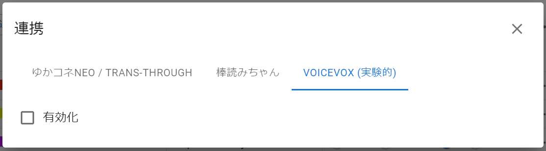

① Connect via Integration
Open Integration from the menu at the top right of OneComme
CommentersStop speechClear commentsSpeechPersistSettingsTemplatesDummy CommenterIntegration
Open the "VOICEVOX" tab
IntegrationYUKARINETTE CONNECTOR NEO / TRANS-THROUGHBouyomiChan
To integrate, check "Enable"
If the VOICEVOX integration succeeds, the Speech Voice list will be displayed
If it isn't, check that VOICEVOX is running, then click the reload button next to the Speech Voice selector to fetch it again
Select a voice and click "Test Connection" — if it reads text aloud, the connection is complete

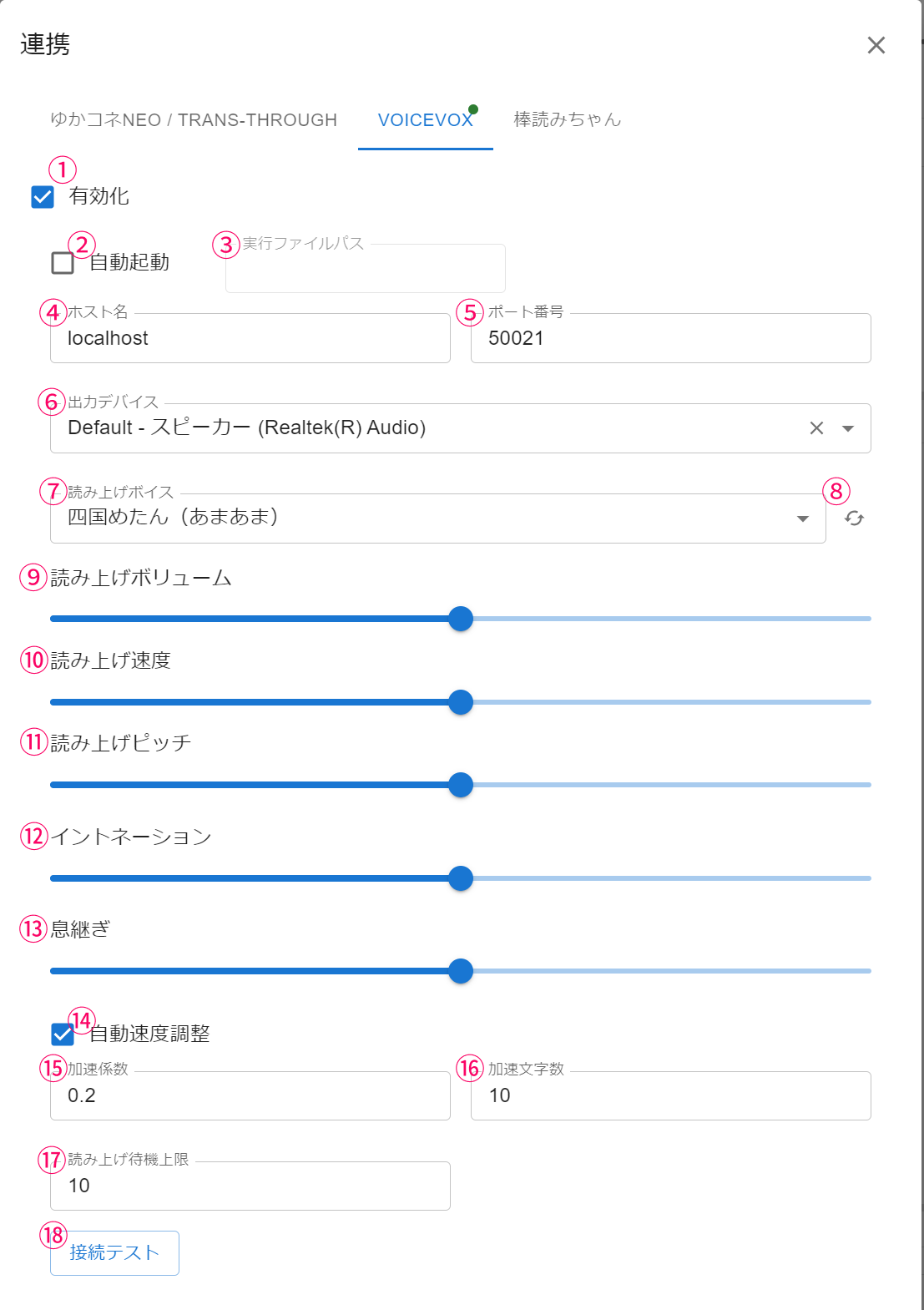

Settings
IntegrationYUKARINETTE CONNECTOR NEO /TRANS-THROUGHBouyomiChanEnabledExecutable File PathAuto RunHostnameOutput DeviceSpeech VoiceShikoku Metan (SweetSpeech VolumePort10 Speech SpeedSpeech Voice PitchIntonationAutomatic Speed Adjustment17 Maximum Queued ItemsTest ConnectionAccelerated Character Count
| ① Enable | Enable speech using VOICEVOX |
| ② Auto Run | Starts VOICEVOX when OneComme starts If you don't need the GUI, we recommend setting the engine's executable file ※If auto-started, it will automatically close when OneComme closes |
| ③ Executable File Path | Specify VOICEVOX's executable file (VOICEVOX.exe, run.exe, etc.) (※1) |
| ④ Hostname | Hostname to connect to (usually no need to change) |
| ⑤ Port | Port number of VOICEVOX's local HTTP server (usually no need to change) |
| ⑥ Output Device | Select the device to play the Speech Voice on If not selected, it will play on the default device |
| ⑦ Speech Voice | Voice used for speech |
| ⑧ Refetch | Refetch the Speech Voice list from VOICEVOX |
| ⑨ Speech Volume | Adjust speech volume |
| ⑩ Speech Speed | Adjust speech speed |
| ⑪ Speech Voice Pitch | Adjust speech pitch |
| ⑫ Intonation | Adjust speech intonation |
| ⑬ Taking A Breath | Adjust breathing during speech |
| ⑭ Automatic Speed Adjustment | Automatically adjusts speech speed according to length |
| ⑮ Acceleration Coefficient | Increases speed by the specified coefficient for every ⑯ characters |
| ⑯ Accelerated Character Count | Increases speed for every specified number of characters |
| ⑰ Maximum Queued Items | Automatically skips older items once the specified number has built up, to prevent speech from backing up too much |
| ⑱ Test Connection | Run a speech connection test |
※1 - On Mac, you can set this automatically using the steps below
- Right-click the VOICEVOX app to open the menu
- While the menu is open, hold down the option key
- Select "Copy '"VOICEVOX"' as Pathname"
- Paste the copied path into the Auto Run executable file path field
