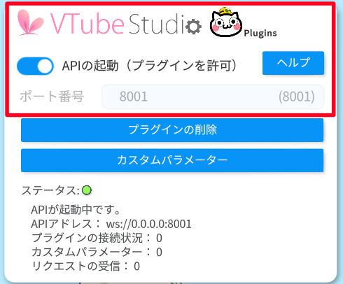

Preparing VTubeStudio

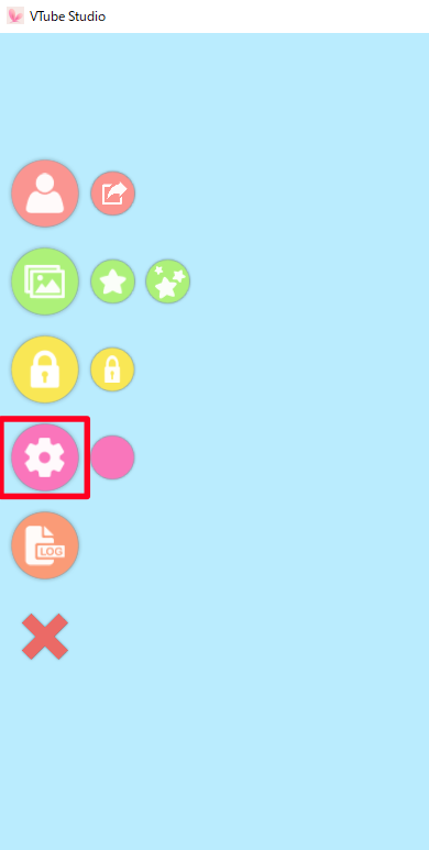

Launch VTubeStudio and open its settings.
Find the "VTubeStudio Plugins" item around the middle of the settings.
Check "Start API (Allow Plugins)".
Start API (Allow PluginsPortDelete PluginCustom ParametersHelpAPI is runningAPI Address: ws://0.0.0.0:8001Plugin Connections: 0Custom Parameters: 0Requests Received: 0
※ Make sure the port number is set to 8001
※ If it's different, quit whatever application is using port 8001 before launching VTubeStudio

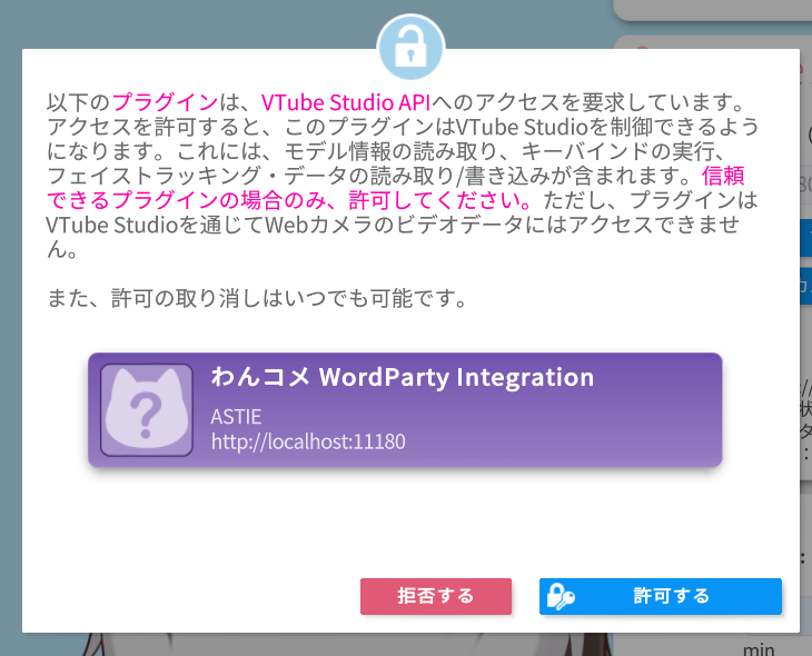

Preparing OneComme
Configuring the integration
Open "top-right menu > Integrations".
StopClear commentsSettingsTemplatesDummy CommenterDictionaryIntegration
Scroll the top tabs sideways to select "VTubeStudio", then check "Enable".
IntegrationEnabledExecutable File PathAuto RunHostnamePort
After that, verify that the port number matches the one shown in VTubeStudio.

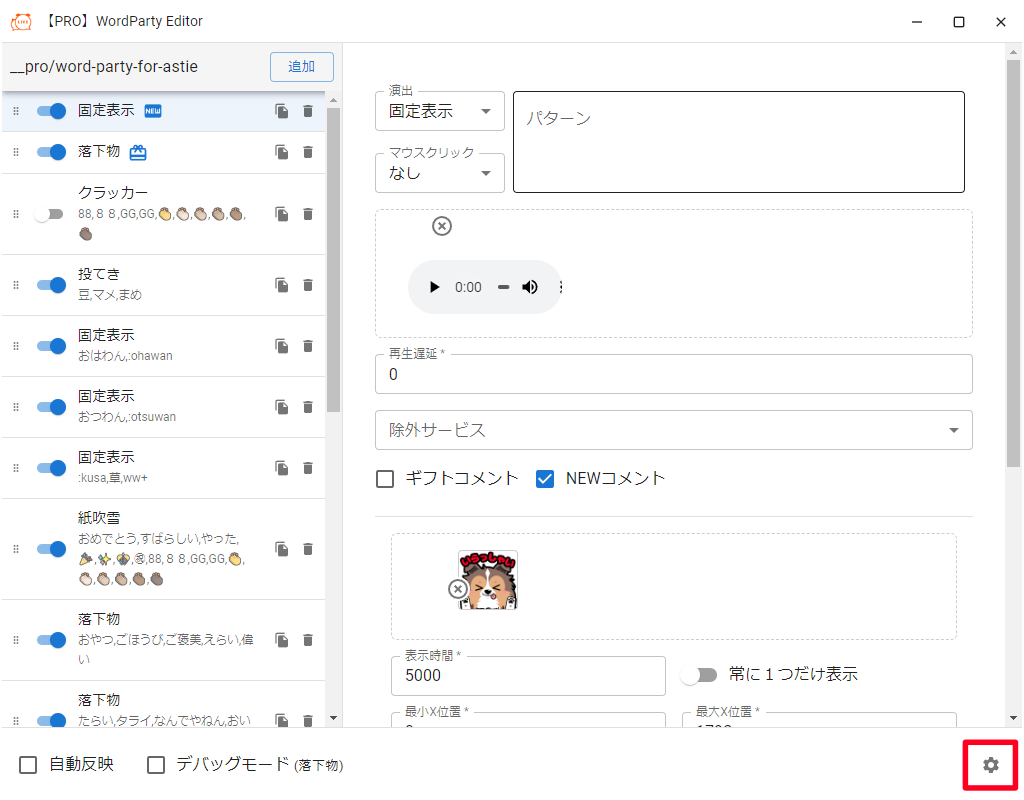

Configuring WordParty

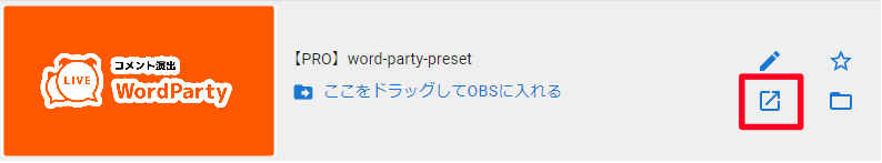

Open the WordParty editor from Templates.
After clicking the add button, select "Fixed Wall" as the effect.
GeneralCrackerNice, niceConfettiConnectorWorkingFolder ProfileNameEffectCrackerFixed coordinatesConfetti (PROThrowing (PROConnector (PROPatternWidthPreviewDentisityCoefficient of restitutionTracking with VSTDisabled FolderFrictionInjection anglePreviewHeight

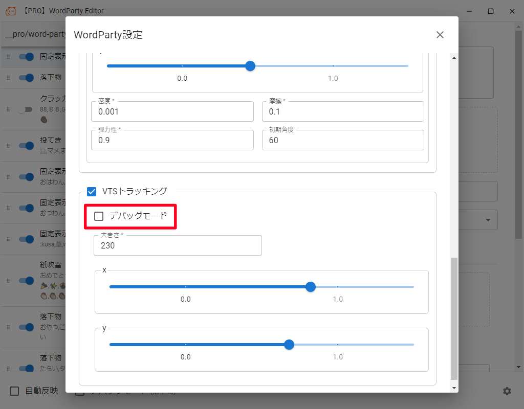

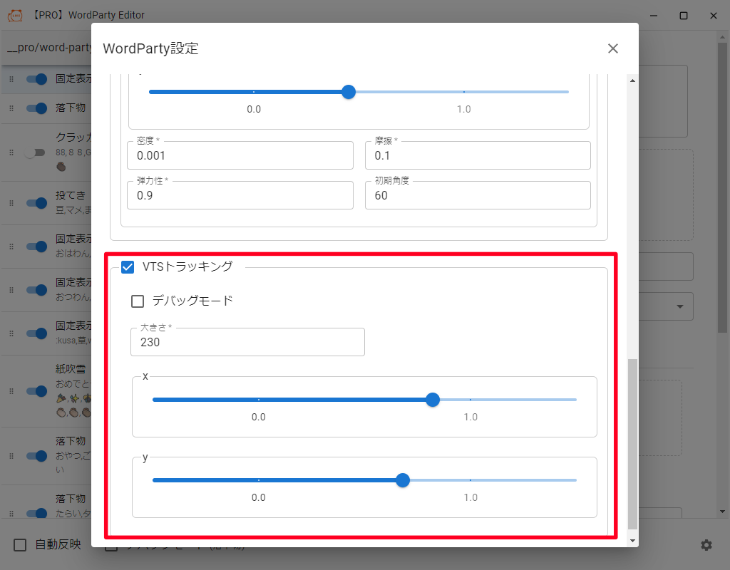

Check "Tracking with VST".
Also check "Visualization" now, since you'll need it for position adjustment later.
EffectMouse ClickOFFPatternVisualizationshapeRound shapeWidthPositionPreviewDentisityCoefficient of restitutionTracking with VSTSensitivityOriginInjection angleHeight
  • 摩擦 → Friction
With Visualization checked, the wall becomes visible once it's placed in OBS.

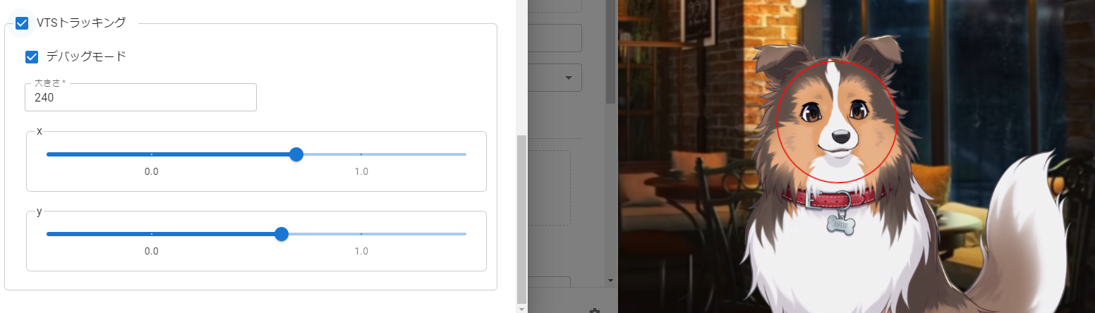

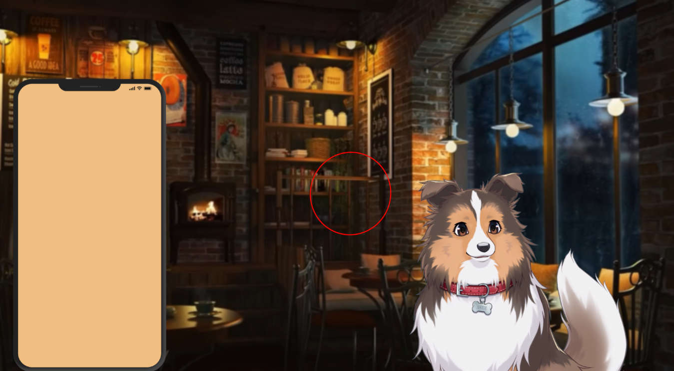

When you add the WordParty template to OBS, a visualized circle and origin point appear as shown below.
Example setup:
shapeRound shapeWidthHeightPositionPreviewDentisityCoefficient of restitutionInjection angle
Adjusting sensitivity
With VTubeStudio running and tracking active, turn your head to the side and up to check how the circle moves.
If the circle moves more than the model does, set the value below 1, such as 0.8.
If the circle moves less than the model, set the value above 1, such as 1.2.
Adjusting the origin point
Since the reference position for angles differs between models, adjust the origin point.
Changing the origin point moves the red dot (generally, it's best to align it with the neck position).
Example setup:
Now, if you turn your head left and right, you'll see the circle rotate around the origin point.
Finally, uncheck "Visualization" under "Fixed Wall" and the setup is complete.
